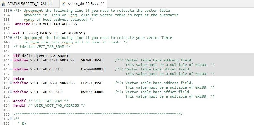

I'm using the cubeide 1.6.1 version.
There's a problem with using the bootloader this time.
This is bootloader code
#define APPLICATION_ADDRESS    (uint32_t)0x08010000
typedef void (*pFunction)(void);
pFunction JumpToApplication;
uint32_t JumpAddress;
​int main(void)
 /* USER CODE BEGIN 1 */
 /* USER CODE END 1 */
 HAL_Init();
 /* USER CODE BEGIN Init */
 /* USER CODE END Init */
 SystemClock_Config();
 /* USER CODE BEGIN SysInit */
 /* USER CODE END SysInit */
 MX_GPIO_Init();
 MX_ICACHE_Init();
 MX_USART1_UART_Init();
 MX_RTC_Init();
 /* USER CODE BEGIN 2 */
 setvbuf(stdout, NULL, _IONBF,0);
 printf("\r\nstart!!!");
 Jump_to_app_flash();
 HAL_Delay(100);
void Jump_to_app_flash(void)
// HAL_RCC_DeInit();
// SysTick->CTRL=0;
// SysTick->LOAD=0;
// SysTick->VAL=0;
// __disable_irq();
// Jump to user application
JumpAddress = *(__IO uint32_t*)(APPLICATION_ADDRESS + 4);
JumpToApplication = (pFunction) JumpAddress;
// Initialize user application's Stack Pointer
__set_MSP(*(__IO uint32_t*) APPLICATION_ADDRESS);
JumpToApplication();
and

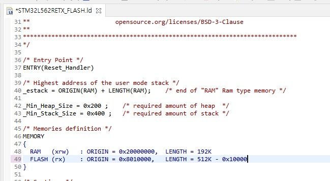

I changed the main code setting like this.
I'm want to jump from 0x8000000 bootloader to 0x8010000 main firmware.
There's an error in the jump.
I downloaded the firmware with a cubeprogrammer.
In this case, how should I solve this?

Try to set Jump variables in "static" like this:
static pFunction Jump_To_Application;
static uint32_t JumpAddress;
I had the same issue using STM32L562VET6 and ARM Compiler V6 on Keil.
