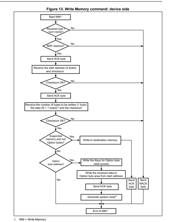

I guess I should have given a bit of background on what I am trying to do instead of just saying UART, thats my bad :grinning_face_with_sweat:. I would like to do the update from another board connected to the STM32 (probably just an arduino to get started after I get it working via terminal). So cubeprogrammer isnt really what I am looking for. However, I am not even using another board yet! Just using RealTerm to send hex commands.
To get me started, I was following AN3155 ( https://www.st.com/resource/en/application_note/cd00264342-usart-protocol-used-in-the-stm32-bootloader-stmicroelectronics.pdf ) to communicate with the bootloader. As you mentioned the basis for my flash is 0x08000000. The size of the binary I am trying to write is 20KB (just trying to flash a blinky program for now). But i just realized the maximum number of bytes to send per the documentation is 256 so i split my binary into multiple .bin files of 239 bytes however trying to write that to flash just results in a bunch of NACK responses. Below is the flow chart I am following. Failure seems to happen at the last "Checksum OK?"

That's the right thing to do. Probably your checksum or number of bytes is wrong. Try writing 4 bytes instead until you get it working.
0x31 0xCE
ACK
0x08 0x00 0x00 0x00 0x08
ACK
0x03 0x00 0x00 0x00 0x00 0x03
ACK

The 4 bytes was successful. So I revisited what I was doing and I get a NACK when i send my checksum value.
The process:
0x31 0xCE
ACK
ACK
0xEF (bin data with size of 239 bytes) 0x00 0xEF
NACK
If I am doing the checksum correctly my best guess is that the program I am using (RealTerm) is not sending the .bin how I would expect since my only option is to "Dump file to port"...

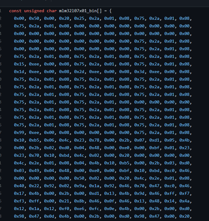

Thanks that is helpful especially seeing how the FW is stored in a header file:
0693W00000D1AL3QAN.pngI think converting my .bin or .hex file to an array of hex values like the one above may help quite a bit. I feel like I'd have some serious problems trying to send an Intel .hex or .bin file from another board through UART. It looks like there is a tool to just do that:
https://developer.arm.com/documentation/ka004285/latest
