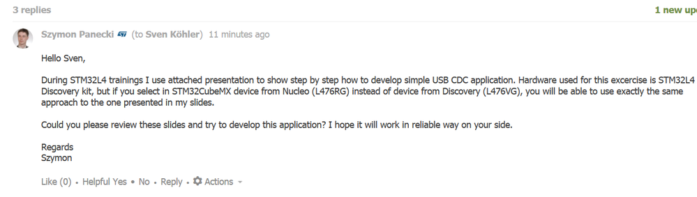

During STM32L4trainings I use attached presentation to show step by step how to develop simple USB CDC application. Hardware used for this excercise is STM32L4 Discovery kit, but if you select in STM32CubeMX device from Nucleo (L476RG) instead of device fromDiscovery (L476VG), you will be able to use exactly the same approach to the one presented in my slides.
Could you please review these slides and try to develop this application? I hope it will work in reliable way on your side.

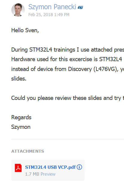

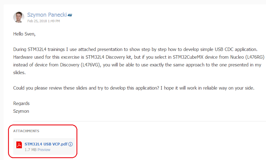

Posted on February 25, 2018 at 13:57
You should be able to see it below my message. I can see it on my side like on picture below. Is it visible also for you?
Regards
Szymon
Posted on February 25, 2018 at 14:02
Unfortunately not. It is not the first time when you share valuable pdf files but I cannot see them. Initially I was thinking that you send these file using private message.
MAybe I canno use this forum,
What I see:
Posted on February 25, 2018 at 14:12
Thanks for the feedback. I am sorry for this inconvenience. I was not aware of this problem. Unfortunately I am not able to tell you how to solve it.
