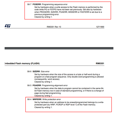

Did you look those codes up?
HAL_FLASH_ERROR_PGS =  Programming Sequence error;
HAL_FLASH_ERROR_WRP = Write protection error.

For debugging a uploaded a code and when it went to Error_Handler(), I read g_erase_error_code value which is 0x24(which I believe a combination of 2 errors 0x20(HAL_FLASH_ERROR_PGS) and 0x4(HAL_FLASH_ERROR_WRP)).
