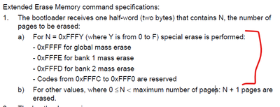

Hi everyone,
I am using an STM32h7 to program an STM32L151 using the system bootloader through usart.
When I ask for the supported commands, I get that the erase command is between them but, surprisingly, when I try to use it I get a nack.
Then I read that some MCUs do not support the erase command and so my first question is: does the STM32L151 support the erase (or extended erase) command?
Then I tried to erase the flash enabling and then disabling the RDP level 1, that is working but, after this operation, I find also the option bytes changed respect to the default (I read {0xffff0000, 0xffff0000, 0xffff0000, 0xffff0000, 0xffff0000} instead of {0xFF5500AA, 0xff0700F8, 0xffff0000, 0xffff0000, 0xffff0000} at address 0x1FF80000).
So at the moment my firmware update process is working but, instead of sending a single erase command I have to:
- set RDP level 1
- restart the uP
- set RDP level 0
- restart the uP
- re-write default option bytes
- restart the uP
My second question is: am I doing something wrong or is expected to follow these steps the perform a flash erase?
Thank you,
regards
Arianna
I have the reply I was looking for:
the extended erase command is supported, but only for the single page erase, i.e. it is not possible to perform the 'special erase' described in the application note AN3155:
Here there are the byte sequences:
  1.  handshake and get info:
    tx: 7f
    rx: 79
    tx: 00 ff
    rx: 79 0b 31 00 01 02 11 21 31 44 63 73 82 92 79
  2. global mass erase
    tx: 44 bb
    rx: 79
    tx: ff ff 00
    rx: 1f
  3. bank 1 mass erase
    tx: 44 bb
    rx: 79
    tx: ff fe 01
    rx: 1f
  4. single page erase
    tx: 44 bb
    rx: 79
    tx: 00 00 00 00 00
    rx: 79
No, there's no reason to set RDP=1 then to 0 to do a flash erase.
The bootloader versions are given in AN2606 for your chip. "STM32L151" is not specific enough to tell.
The GET command can be used to determine supported commands.
Note that ERASE and EXTENDED ERASE are mutually exclusive. Your bootloader will support one of them. Probably EXTENDED ERASE is the only one supported.

The link you have is pretty conclusive, it just isn't supported here, bizarrely. Bummer.
> I checked and this device (as well as for example STM32L1 series) do not implement the mass erase in the bootloader. The BL code space was simply too small on this device to fit the mass erase. Sorry.
Should be able to do page-by-page erase though.
    tx: 7f
    rx: 79
    tx: 00 ff
    tx: 44 bb
    rx: 79
    tx: ff ff 00
    rx: 1f
    tx: 44 bb
    rx: 79
    tx: ff fe 01
    rx: 1f
    tx: 44 bb
    rx: 79
    tx: 00 00 00 00 00
    rx: 79
