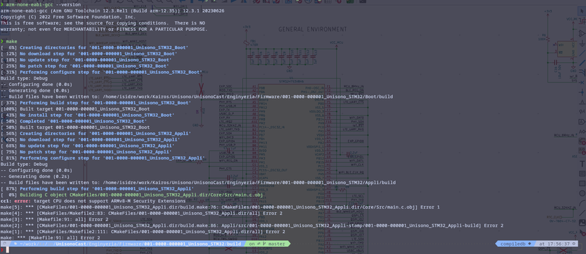

I'm starting a new project where we use the STM32H7S3V8H, and with the code generated with the STM32CubeMX (see IOC file attached) it compiles perfectly the Boot code but the Application code allways fail with the following error message:
"cc1: error: target CPU does not support ARMv8-M Security Extensions"
We don't have idea what we must do in the IOC to change this situation. Anyone knows why this error is happend? Any clue?

2024-10-14 8:30 AM - edited 2024-10-14 8:31 AM
Hello @Isidre Sole
Could you check that you are not using -mcmse flag when building the project with gcc.
KR,
Souhaib
2024-10-14 9:05 AM
Yes it is used on the App side, not in the Boot side.
I removed it in the CMakeList.txt and it compiles completely.
Why STM32CubeMX places it?
How can I deselect that in the IOC file?
Thanks a lot @Souhaib MAZHOUD
