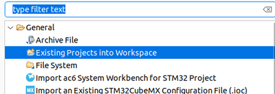

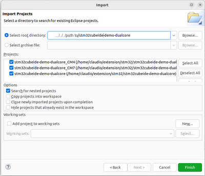

Import the project with option:
three projects..
Generate the code and build projects.

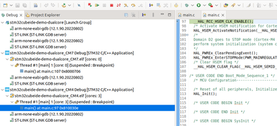

Then run the debug with "stm32cubeide-demo-dualcore"
Wait the download and main enter for both processors:
Run the CM4, it should go in this state:
Run the CM7, it should go in running:
Return in CM4, press run button, it should go in running:
Now both cores are running...

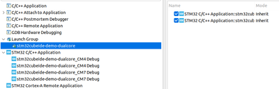

In order to obtain this I made a "Launch Group" that run the two launcher.

In CM7 debug configuration, you need to:
  1. Select ST Link GDB server
  2. Define Access port 0 for CM7
  3. Connect under reset
  4. Enable shared ST LINK
  5. In startup tab, add CM4 image file .elf and list it before CM7 elf file then save.
In CM4 debug configuration:
  1. Set debug probe ST link GDB server (port number 61238)
  2. Define Access Port to 3 for CM4
  3. Set None in reset behavior.
  4. Enable Shared ST Link
  5. In startup tab, edit the CM4 image and disable download (it will be done by CM7).

  • start the CM4 (CM4 at semaphore check goes in stop);
  • start the CM7;
  • restart the CM4 (that is waiting at the semaphore);
Now you can debug...
