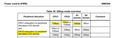

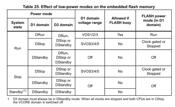

Thanks for the insight. I have a follow-up question regarding the memory architecture:
My CPU2 (CM4) is currently executing code directly from Flash memory (mapped at 0x08100000), while its stack and data are in D2-domain RAM (0x10000000).
Since the Flash memory controller is physically located within the D1 domain, does entering DStop on D1 effectively cut off the Flash clock or power for the entire system?
If so, does this mean that CPU2 (running in D2) is physically blocked from fetching instructions the moment D1 enters DStop, even if the D2 domain itself remains in DRun? I suspect this 'hidden' dependency on the D1 bus matrix is what's causing my CM4 to stall, as it works fine in Sleep mode (where the D1 bus remains active).
I’ve also observed that if D1 is in RUN/SLEEP mode, then D2 does not properly enter or operate in STOP mode.

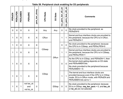

It looks like the issue is related to LPTIM2 being located in the D3 domain.
In my setup:
  • When I use LPTIM2 as the wake-up source for CM7 or CM4, STOP mode behaves incorrectly
  • However, when I switch to LPTIM1, i can manage to put corresponding core to sleep.
    So how can i force LPTIM2 to run normally?
Hello @Patryk_Kucia
According to the RM table 59, D3 peripherals can remain clocked in STOP mode if autonomous mode is enabled (LPTIM2AMEN = 1) and its kernel clock source is a low-power clock that remains active in D3Stop, i.e. LSE or LSI.
If LPTIM2 is clocked from PCLK/PLL or AMEN is not set, it will not run in STOP.
