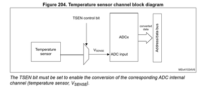

did you set Tsen ?
Hello, thanks for the reply
Yes indeed I set the TSEN with the following :
ADC3_COMMON->CCR |= ADC_CCR_TSEN;
And then I run the calibration
@AScha.3 It is still showing the same output even thought I enabled TSEN
HAL_ADCEx_Calibration_Start(&hadc3,ADC_CALIB_OFFSET_LINEARITY, ADC_SINGLE_ENDED);
Any ideas ?

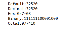

What values you get from ADC real ? (in hex)
Dear @AScha.3,
With the following ADC value inside DMABuff (0x7f08):
I get
  1. Temperature = 734 C°
  2. ADC (in mV) = 2413.89
  3. adcCalTemp30C = 13 820
  4. adcCalTemp110C = 18 233

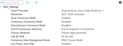

In Cube, adc setup, you set to : 16bit , no oversampling, no shift ?
@AScha.3, appreciate the fast replies
I define :
CALIBRATION_REFERENCE_VOLTAGE as 3.3V
REFERENCE_VOLTAGE 3.0V // supplied with Vref+ or VDDA
Then :
adcCalTemp30C = (float) (*ADC_TEMP_3V3_30C) / (REFERENCE_VOLTAGE/CALIBRATION_REFERENCE_VOLTAGE);
adcCalTemp110C = (float) (*ADC_TEMP_3V3_110C) / (REFERENCE_VOLTAGE/CALIBRATION_REFERENCE_VOLTAGE);
And also here is how I set the ADC3 in Cube
