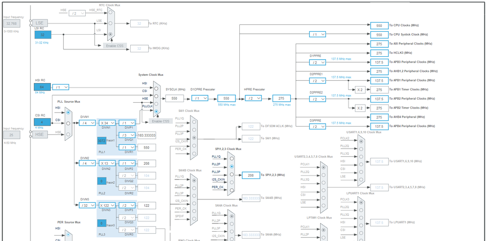

What's the primary I2S clock source?
Is that stable?
I am using the HSI -> PPL2P -> SPI1
Gkatsos
So I have finally fixed the problem, my reluctancy to acknowledged using the HSI could be the problem has been my downfall.
I have tried adding 24.576 MHz to is2_ckin, and now everything is stable...
