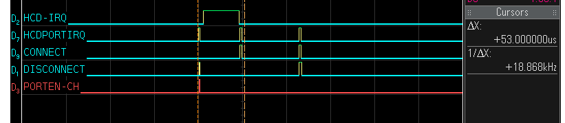

Microman
MicromanAuthor
February 24, 2020
I did a bit of debugging and found out that the false connect detection (as any other USB connect event) deactives the DISCINT interrupt in GINTMSK (USB int.mask reg -> 0) insinde HCD_Port_IRQHandler(). However the DISCINT flag itself still works and shows that we are in a correct disconnected state (logical 1). It is just the USB HOst stack that did not get the latest disconnect state. I can get back to proper USB operation by clearing DISCINT (writing a 1 to it) and enable DISCINT in GINTMSK. After these two bit operations, I can unplug/plug the USB Stick and everything works fine again.
I don't know for what reason ST masks and unmasks the DISCINT inside the HCD_Port_IRQHandler() each time a stick is inserted - to be honest, I did not dig deeper into this machinery. It would be nice I could use the USB host code from ST without any "work arounds".
Microman
MicromanAuthor
February 25, 2020
Here is what happens when unplugging a certain USB stick (Mass Storage Class)
The first disconnect irq is poperly handled. HCD-IRQ shows the execution of the disconnect callback routine wich takes a moment.
Directly after this, a connect is detected again witch is also properly handled, but the next event 114us later shows another port connect (USB_OTG_HPRT_PCDET and USB_OTG_HPRT_PCSTS are 1) and a disconnect (USB_OTG_GINTSTS_DISCINT) at the same time.
This kills the Cube USB stack and due to this, it stays in the connected state forever. Later (dis)connects also do produce irqs but these will not bring back the USB stack back into operational mode.
