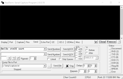

I am trying to STM32G0B1 USART3 DMA receiving data from PC and do processing on MCU.
I add code in callback function HAL_UARTEx_RxEventCallback()
these code are try to get the whole package ending with '\r' and set a flag to notice the FreeRTOS get the whole package and do process in FreeRTOS.
After running some times, No more flag set in the callback. In my test, 1st send "test", 2nd send "this is a test of stm32", 2nd callback is not triggerred.
Is there any wrong? Or what is the right procedure to get the whole package in DMA callback and set flag to FreeRTOS Application layer to do future process?
Thanks.

The code for HAL_UARTEx_ReceiveToIdle_DMA() will enable the IDLEIE bit, hence enable the IDLE interrupt source within the UART instance. Now, to be generated and processed, the UART IRQ on the NVIC side must also be activated.
Have you enabled the USART3 interrupt in NVIC?
If you generate your code using the STM32CubeMx tool, make sure to do so in your UART settings panel.
Hi Sarra,
It works after changing below,
