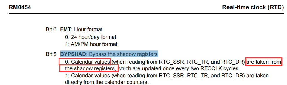

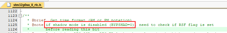

STM32G0 RTC RSF Which is correct?
lyiku.1

Hello @lyiku.1​,
Thanks for your post and for bringing this issue to our attention.
I have created an internal ticket in order to correct the note in the header file.
Internal ticket number: 149356 (PS: This is an internal tracking number and is not accessible or usable by customers).
When your question is answered, please close this topic by choosing Select as Best.
Imen

Imen.D
Hi @lyiku.1 ,
I closed this thread as the issue is fixed in the latest release of STM32CubeG0 package.
Thank you for your contribution.
