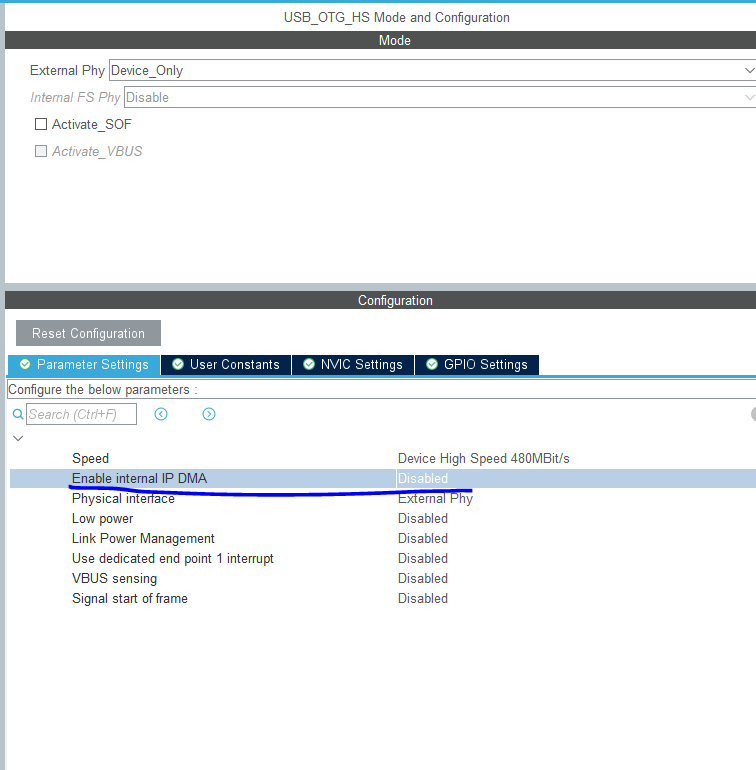

I'm currently working on a project using the STM32F723 Discovery kit and USB as a Virtual Com Port (VCP) in CDC mode. I'm encountering an issue related to DMA and USB_OTG_HS when using the CubeMX configuration with the "Enable internal IP DMA" flag enabled.
The problem I'm facing is that when the "Enable internal IP DMA" flag is enabled in CubeMX, the application can echo the received data from the USB CDC RX buffer for only about three times. After that, it fails to send any data out over the CDC_OUT endpoint. Upon debugging, I found that the CDC_Transmit_HS function always returns USBD_BUSY, indicating that the transmission is still ongoing.
I have verified that without enabling the "Enable internal IP DMA" flag, the application works fine and can echo the received data without any issues. However, I would like to take advantage of DMA for better performance and efficiency.

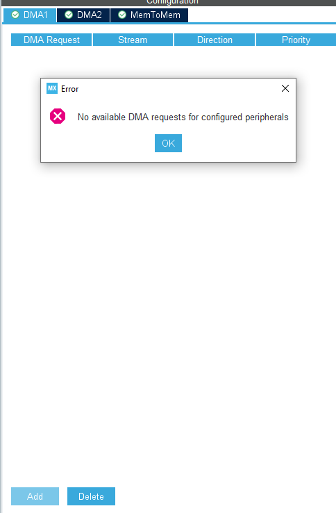

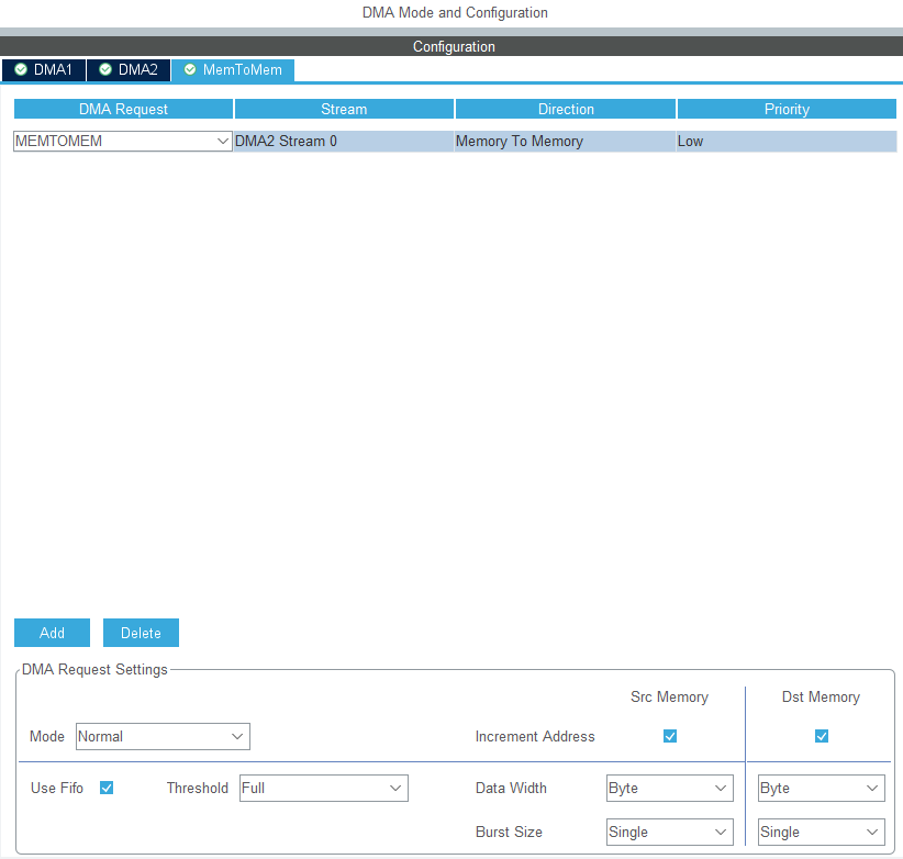

What I was wondering is, that I don't find any DMA functionality in the usbd_cdc source files.
Further if I check the CodeMX there is no peripheral connection possible for DMA <-> USB possible only M2M:
_legacyfs_online_stmicro_images_0693W00000bkfSIQAY.png I can add a M2M like this:
But do I have to add this or should the DMA for USB be somehow autmatically included when enabling the IP DMA?
Best regards
Corsin
mohamed.ayed
Hi @CObri.1​ , if you went to use internal USB DMA, you juste need to enable it in USB Configuration
Regards,
Mohamed
