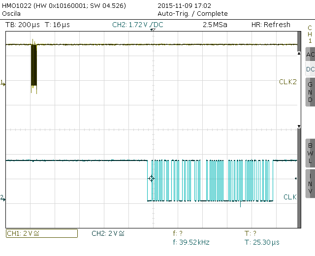

I'm trying to use multiple UARTs on the STM32F446 Nucleo board. I used STM32CubeMX to generate code that initializes all available UARTs and USARTs at 115200 baud and the MCU to run at 180MHz.

However I only receive output on UART2 and UART3, all other UARTs are silent. When connecting a scope it turns out that the other UARTs are much faster (the yellow line is UART6, the blue line UART3). 0690X00000605awQAA.png Why is that? What can I do to make them usable? They are all initialized in the same way (see usart.c). #stm32f446 #hal #uart

It works when I use
RCC_OscInitStruct.PLL.PLLN = 160;
instead of
RCC_OscInitStruct.PLL.PLLN = 180;
Does that mean the MCU will only run at 160MHz?
Posted on November 09, 2015 at 22:21
I'm pretty sure APB2 would need to be slower than DIV1, and flash wait states greater than 3, for 180 MHz operation. Review the RM
