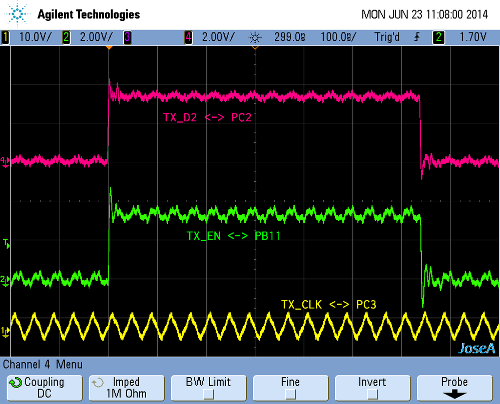

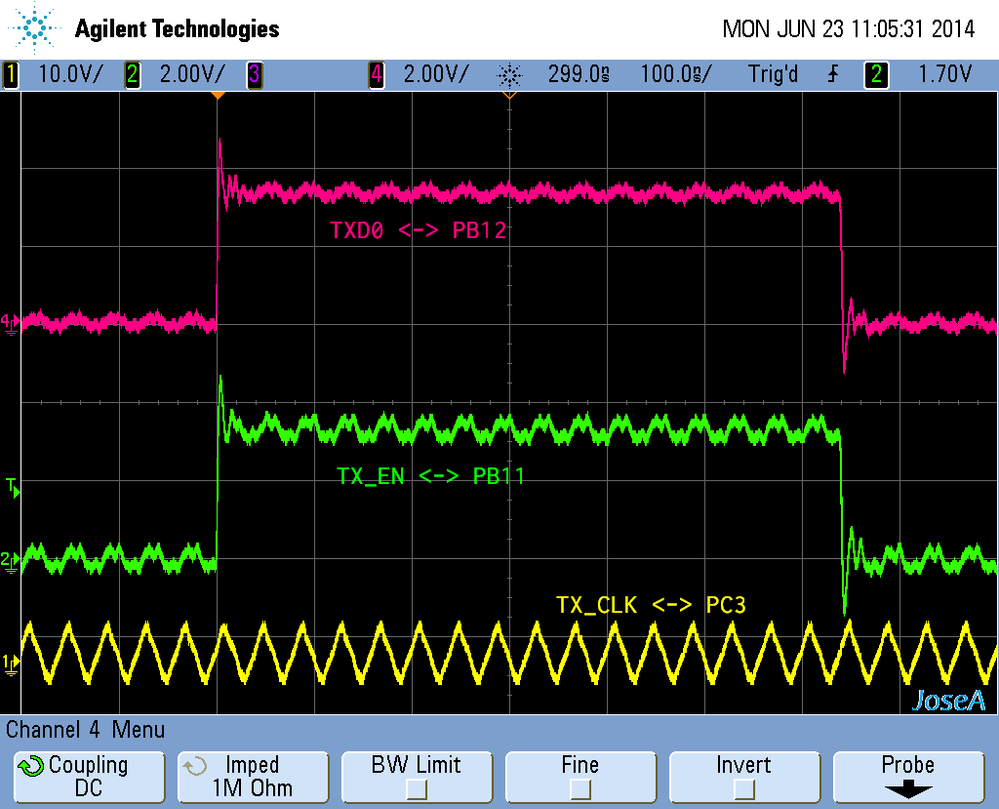

I am experimenting some trouble with the transmission data pins from STM32F4 (TXD0-3). With an oscilloscope, I have tested this pins and the signal is always the same (and wrong). Reception pins work fine.
Also I have tested the same source code with an STM32F4 evaluation board, and all work OK.

5 REPLIES 5
Posted on June 20, 2014 at 14:03
Issues with Ethernet PHYs usually come down to a couple of things:
Pin configurations and connection.
Clock speeds, routing, expectations.
PHY configuration address, and internal configuration.
I don't see any code or schematics, and don't really know what ''wrong'' means in this context.
Suggest you look at other STM32 designs that have used this Micrel part successfully.

At this moment I can't access to the physical device to get the waveforms from the MII interface. I will check these points and  I'm trying to upload more information on Monday.
Regards, Jose A.

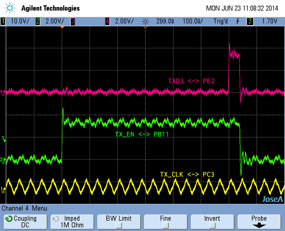

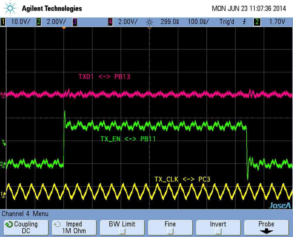

I am using MII_MODE with NO PHY_CLOCK_MCO. Also my pin configuration is like the discovery board (second column in
ETH_GPIO_Config
function). When I run the program, I can read from KSZ transceiver the information (CIDR = 0x8443) which is OK. I attach screenshots from the transmission related pins. The waveform of TXD0, TXD1, TXD2 and TXD3 is always the same and it doesn't change. 0690X000006055kQAA.png 0690X000006058EQAQ.png 0690X000006058FQAQ.png 0690X000006058JQAQ.png
