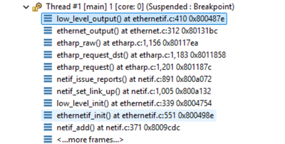

but now I want to use freertos and have a UDp server, but when configuring freertos, stm32f407vet6 gets stuck inside MX_LWIP_Init();, the firmware version for STmf4 is 1.28.1,  here is the code:

Captura de tela 2025-01-27 111611.pngCaptura de tela 2025-01-27 111625.pngCaptura de tela 2025-01-27 111648.pngCaptura de tela 2025-01-27 111659.pngCaptura de tela 2025-01-27 111707.pngCaptura de tela 2025-01-27 111717.pngCaptura de tela 2025-01-27 111726.pngCaptura de tela 2025-01-27 111738.pngCaptura de tela 2025-01-27 111746.pngCaptura de tela 2025-01-27 111750.pngCaptura de tela 2025-01-27 111754.png
So where, exactly, does it get stuck?
using the debugger, it gets stuck when executing this line:
netif_add( &gnetif, &ipaddr, &netmask, &gw, NULL, &ethernetif_init, &tcpip_input );
Again, please see How to insert source code.
So, again, step into that function to see where, exactly, it gets stuck.
Also see this on getting debug info out of LwIP:
https://community.st.com/t5/stm32-mcus/using-the-itm-console-for-printf-redirects-and-lwip-debug/ta-p/723472
Compare & contrast the working & non-working cases.
STackPointer64
Hello @Mauricio_Vieira,
In your case, the application is stuck during the LwIP initialization due to insufficient stack size. You should increase the stack size to at least 256 words, preferably 512 words.
