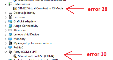

Here are two examples that look functional and can be compiled for F401 on our board
1. https://visualgdb.com/tutorials/arm/stm32/usb/
2. http://stm32f4-discovery.net/2015/08/hal-library-21-multi-purpose-usb-library-for-stm32fxxx/
1 is "click-click and go" ... but Visual GDB not properly working with my ST-link 2 from Aliexpress. I was must use the ST-link utility to load flash.
2 have good documentation, but was more difficult to put into operation. First test "bricked" the board:-) And i was must inject 1,4 MHz to oscillator input to reuse it.
Final problem is some on both examples:
0693W00000AMurAQAT.pngTested on 3 computers with win10. With and without installed STM vcp drivers and all results is identical as this image.
waclawek.jan
April 29, 2021
As I've said, USB is not simple.
The best thing to do is to observe enumeration and subsequent requests on the bus, using a dedicated USB bus analyzer, or some of the LA/oscilloscopes which support USB protocol decoding (e.g. the Asix LA offerings).
Do you have implemented the SendEncapsulatedCommand and GetEncapsulatedResponse requests, required as per USB CDC PSTN subclass, for Abstract Control Model? If yes, continue debugging by observing all unhandled class-specific requests which may arrive from the host.
Ons KOOLI
April 29, 2021
Hi PHude.1,
The support of the VCP interface is managed through the ST Virtual COM Port driver available for download from www.st.com. Please make sure that you are using this driver.
Best Regards,
Ons.

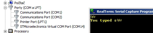

PHude.1
PHude.1Author
April 29, 2021
Update:
Now I tested example 1 on my old computer with win7 and working OK:
Ons KOOLI:
ST VCP drivers is only for older windows
On your link is:
"Windows® 10, the STSW-STM32102 driver is no more adequate and the usage of the native inbox driver is recommended."
I try win8 version on win10, but does not start instal process.
My win10 result is: Not running on my notebook and two work computers.
