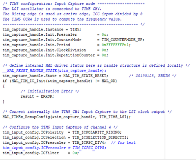

We are currently using the ST32F4 MCU.

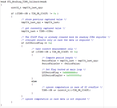

During operation, we are using self-diagnostic code provided by ST, but after 8 days of normal operation, an EXT_SOURCE_FAIL occurs in STL_MainClockTest(), causing the MCU to reset.
When EXT_SOURCE_FAIL does not occur, the PeriodValue is measured between 11,500 and 11,800. However, when the error occurs, the PeriodValue is around 23,000, approximately twice the normal value.
The function for calculating the Period Value is as follows:
HSE is operating at 25MHz, and LSI is operating at 32kHz.
We are using TIM5's Ch4 for INPUT Capture, and the detailed settings for INPUT Capture are as follows:

the open source example of the clock cross check measurement comes from previous obsolete version of the library. It shows a possible way of implementation measurement required by the standard (Item 3 at Table R1 of 60335-1:Annex R). The faster system clock is gated by slower source (LSI) while sequence of 8 consecutive periods of LSI (set as IPSC divider) is applied to do a single measurement. Number of the gated pulses of system clock is then compared if it fits into expected interval defined here as fixed low limit and high limit constants (see definition of macros CLK_LimitHigh and CLK_LimitLow). If you want to gate shorter interval, you need to adapt these macros, of course. Note when appli runs under XTAL, it is enough to detect harmonic and subharmonic fcy failures.
The problem is the LSI drifts with temperature significantly so you need to operate with adaptable limit range as explained at the attached presentation.
