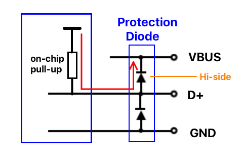

Detecting disconnection (unplug) on USB device
hi Torsten, > Setting a break point in HAL_PCD_DisconnectCallback(), but that is never reached. In the current Cube USB device stack (**1) for OTG_FS and OTG_HS on FS PHY, HAL_PCD_DisconnectCallback() is called in the HAL_PCD_IRQHandler() (stm32f4xx_hal_pcd.c), by GOTGINT.SEDET (session end detected) interrupt Required settings to fire this interrupt are, 1) VBUS (PA9) pin should be connected to VBUS (5V) pin of the USB connector (for OTG_HS on on-chip FS PHY, VBUS (PB13) pin) 2) vbus_sensing_enable is 'ENABLE'd in USBD_LL_Init()

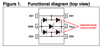

(**1) CubeMX: v4.1 (latest) CubeF7: v1.4.0 CubeF4: v1.0 CubeL4: v1.5.1 A couple of stack / hardware bugs disturb this operation. A) CubeMX bug: On Discovery board, with STMPS2141STR as USB host power switch, CubeMX generates bad initialization code, which supplies 5V rail to the VBUS pin. As the result, device can't detect plug off. Refer to
