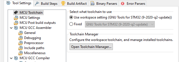

In this thread there is a note about STM32. I am using the STM32 Cube IDE with I believe the compiler recommended. See attached image.
