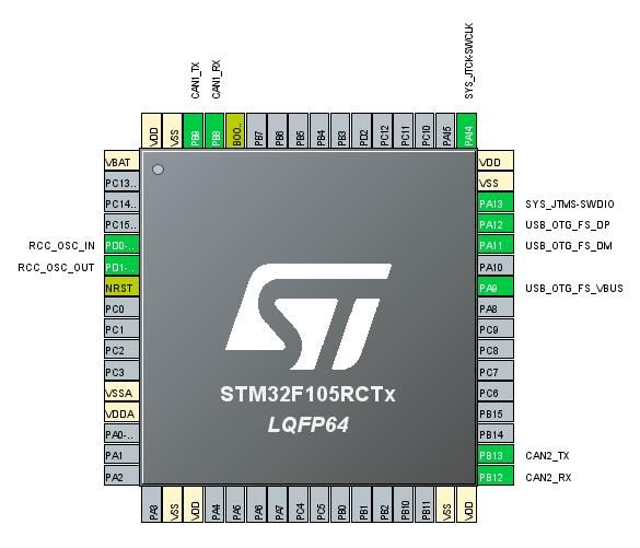

I'm using Cube IDE 1.5.1 and stm32f105rct6 MCU.
I need to get data from CAN1 and CAN2 and send via USB VCP to terminal.
But I get "Unknown Device".

My CAN1 is connected to PB8 and PB9. And USB_OTG_FS - to PA11 and PA12.
I tried remap CAN1
__HAL_RCC_AFIO_CLK_ENABLE();
__HAL_AFIO_REMAP_CAN1_2();
No effect...
ДГори.1
  * @brief Enable or disable the remapping of CAN alternate function CAN_RX and CAN_TX in devices with a single CAN interface.
  * @note  CASE 2: CAN_RX mapped to PB8,  CAN_TX mapped to PB9 (not available on 36-pin package)
  * @retval None
#define __HAL_AFIO_REMAP_CAN1_2()  AFIO_REMAP_PARTIAL(AFIO_MAPR_CAN_REMAP_REMAP2, AFIO_MAPR_CAN_REMAP)
"remapping of CAN alternate function CAN_RX and CAN_TX in devices with a single CAN interface" - why CubeIDE draw CAN1 at PB8 and PB9???
