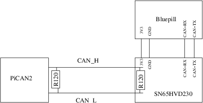

I have a problem using CAN on STM32F103C8T6. I use this MCU on a bluepill board,
a SN64HVD230 based CAN PHY and on the other end of the CAN bus a PiCAN2 board on
Raspberry Pi. I drew a picture to show my setup:
I want to have a 500 kbit/s-CAN-connection, I use the MCU with 16 MHz.

So I have arbitration lost and stuff error and error passive.
If I exchange my Bluepill assembly by an STM8-Discovery-Board running a CAN Hello
world application on STM8, I can send CAN-Messages (500 kbit/s) without problem.
So I assume I made mistakes in my CAN initialization code on STM32.

Finally, I got it. I power the bluepill board via an external 3V3 source and not via USB any more. It may have something to do with the double usage of pins PA11 and PA12 with USB. I tried to remap CAN-RX/CAN-TX it to the alternative PB8/PB9, but it did not work.
‎2020-10-19 12:33 AM
Additional step: If I pull out the USB cable, which means depowering the bluepill board, I can see the CAN message on the bus. How to interpret this?
‎2020-10-19 12:38 AM
Probably some potential shift relative to GND, because of different power supplies.
You could try to disconnect CAN_GND (leaving only CAN_HI and CAN_LO), which usually works as well.
‎2020-10-19 1:05 AM
‎2020-10-22 8:47 AM
Hi @DNeum.1​ ,
I assume that the article "Concurrent use of USB and CAN with STM32F103" provides the explanation for what you see as strange behavior.
-Amel
‎2020-10-22 9:20 AM
Since I used only powering by USB, but not the USB peripheral, I thought it would be no problem. But it was... Thank you for your patience.
