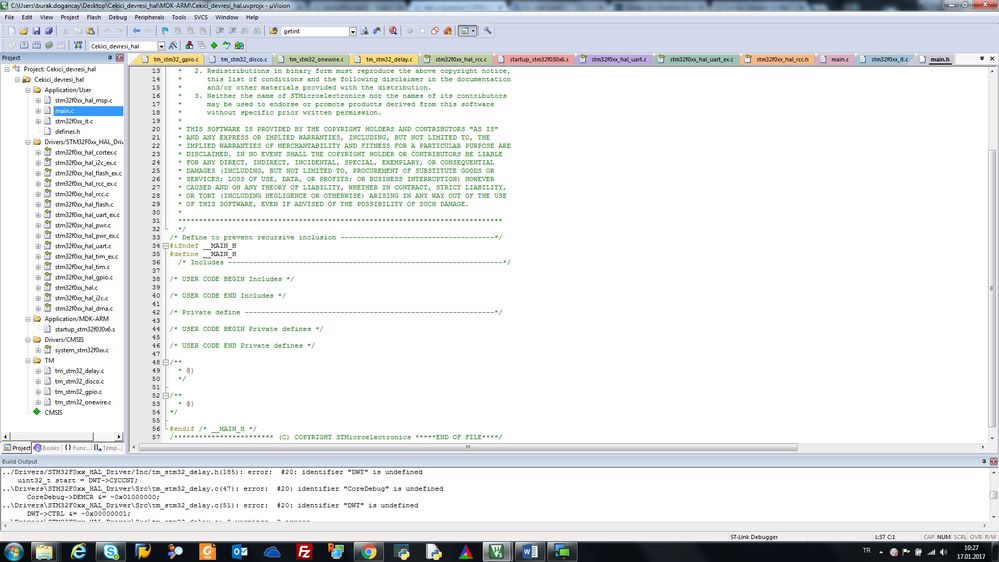

here is my projectview
On the left side I added TM drivers , But after build I get following errors;
../Drivers/STM32F0xx_HAL_Driver/Inc/tm_stm32_delay.h(185): error: &sharp20: identifier ''DWT'' is undefined
uint32_t start = DWT->CYCCNT;..\Drivers\STM32F0xx_HAL_Driver\Src\tm_stm32_delay.c(47): error: &sharp20: identifier ''CoreDebug'' is undefined CoreDebug->DEMCR &= ~0x01000000;..\Drivers\STM32F0xx_HAL_Driver\Src\tm_stm32_delay.c(51): error: &sharp20: identifier ''DWT'' is undefined#onewire #ds2401 #stm32f030f4 #hal-drivers- Labels:

It seem the library uses the DWT counter for delays. F0 does not implement the DWT, so you need another way to implement the One-Wire primitives. Using the Usart is one way to go.

I'd recommend benchmarking a spin loop, in the form
volatile int i = 10000;
while(i--);

You have one timing routine to fix, is there a reason you can't just fix that?
Calibrate a loop, or use a free-running TIM
