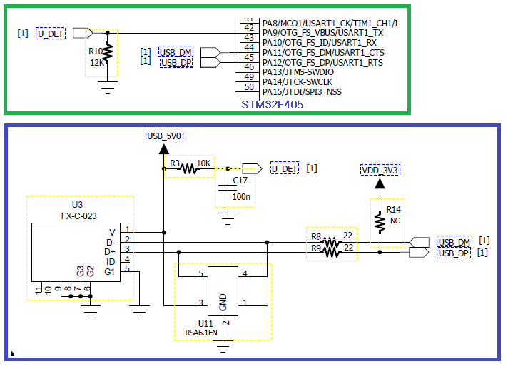

harinath
harinathAuthor
April 16, 2014
Posted on April 16, 2014 at 10:05
See the schematic of my board. I'm not using U_DET pin.
STM32Cube firmware has an sample. The path is
C:\Users\Administrator\Downloads\STM32Cube_FW_F4_V1.1.0\Projects\STM324xG_EVAL\Applications\USB_Device\CDC_Standalone\Src They say:
This example is a part of the USB Device Library package using STM32Cube firmware. It describes how to use USB device application based on the Device Communication Class (CDC) following the PSTN subprotocol in the STM32F4xx devices using the OTG-USB and UART peripherals.
I have removed UART part of the sample as I need only VCP part. But still no luck. My board has 12MHz crystal, I modified HSE_VALUE to 12 MHz. Here is my clock configuration which was also correct.

schauer
April 16, 2014
Posted on April 16, 2014 at 13:22
It might be good to know a few more things:
Do you use a custom or evaluation board?
What exactly is the issue?
If the device is not enumerating, you could check if
 - the USB is clocked (and enabled) accordingly
 - the USB input pins (incl. Vbus) are configured as USB AF
Additionally you could check what happens on the USB Bus. I use Wireshark for that - it is available for multiple operating systems and also capable of capturing/decoding USB packets.

harinath
harinathAuthor
April 17, 2014
Posted on April 17, 2014 at 03:41
Stm32Cube generated project for IAR works, pls find attachment. This means Hardware is fine.
But I still wonder why my code is not working !
see the
usbd_cdc_interface.c and
.h files for what I have modified from sample.
CDC_Itf_Init() and
CDC_Itf_Control()functions must be called, but are not being called. This could be problem.

harinath
harinathAuthor
April 17, 2014
Posted on April 17, 2014 at 10:36
It is working. The problem was with VBUS pin initialization and sensing settings.
I removed VBUS pin initialization in  usbd_conf.c in the following function
void HAL_PCD_MspInit(PCD_HandleTypeDef *hpcd)
also disabled sensing in USBD_StatusTypeDef  USBD_LL_Init (USBD_HandleTypeDef *pdev)
hpcd.Init.vbus_sensing_enable = 0;
It means, I'm not using VBUS now.

harinath
harinathAuthor
April 24, 2014
Posted on April 24, 2014 at 02:17
@STM32Cube-T
The problem i described was not in the CubeMX project. It was in the CDC_Standalone sample in STM32CubeF4 firmware package. Also, the hardware is designed in our lab.
