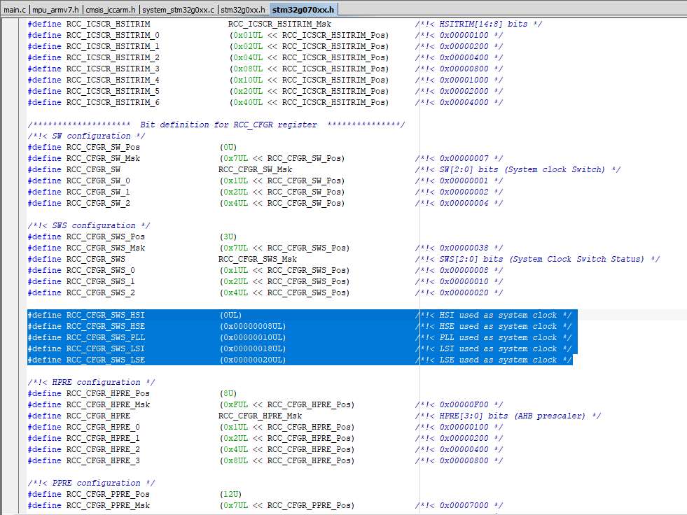

I work with STM32G070RBT. I upgrade FW to STM32Cube_FW_G0_V1.4.0.
These definitions have disappeared from the file stm32g070xx.h:
#define RCC_CFGR_SWS_HSI              (0UL)                                  /*!< HSI used as system clock */
#define RCC_CFGR_SWS_HSE              (0x00000008UL)                         /*!< HSE used as system clock */
#define RCC_CFGR_SWS_PLL              (0x00000010UL)                         /*!< PLL used as system clock */
#define RCC_CFGR_SWS_LSI              (0x00000018UL)                         /*!< LSI used as system clock */
#define RCC_CFGR_SWS_LSE              (0x00000020UL)                         /*!< LSE used as system clock */
My project cannot bild at this time.

I have the same error with STM32Cube_FW_G0_V1.4.0 Firmware Package with no previous versions.
hello @Imen DAHMEN​, @Peko​. I'm having a similar problem after updating the software package in my Keil IDe (currently it is 1.4.0.0).

Right now, I've added these definitions (state below) directly into the "stm32g0xx.h" file, and I wanted to know whether it's a correct method or not.
  * SystemCoreClock variable according to Clock Register Values.
Note* At present, the code is showing no error or warning. It is compiling successfully.

I encountered the same error when switching from stm32g0-hal-1-3-0 to stm32g0-hal-1-4-0. I looked for the definitions that were missing and generating compilation errors in stm32g0-hal-1-4-0 in the old stm32g0-hal-1-3-0 version. I found that in the file stm32g070xx.h from stm32g0-hal-1-4-0 the following definitions are missing:
I copied the definitions from the stm32g070xx.h file from the STM32Cube_FW_G0_V1.3.0 firmware version into the stm32g070xx.h file from the STM32Cube_FW_G0_V1.4.0 firmware version and I managed to compile the project without errors.eroare fw_g0_v140.bmp
