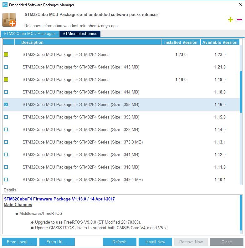

I recommend you to use the latest version of STM32Cube firmware package and STM32CubeMX, which contains enhancement and fixes defects.
If needed, you can download the previous Cube firmware versions from STM32CubeMX tool:  Help > Manage embedded software packages
Note that ST maintains its support only for the last version available on the ST web.

Availability depends on the version of CubeMX being used, ie it won't show things beyond the scope of the release.
https://drive.google.com/open?id=1vmOAOc9wHRahhYnHxJ2sVZI2bA2VE4Yq
