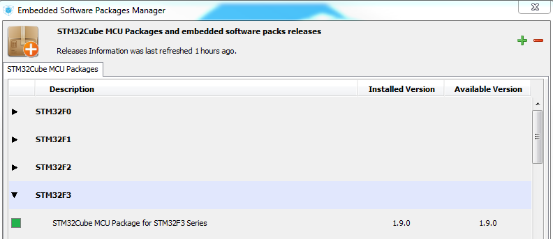

Posted on March 06, 2018 at 13:23
hi, Imen,
Yes, I download the package from st official site exactly from the link you gave me.
And I install the package from local, error happens:

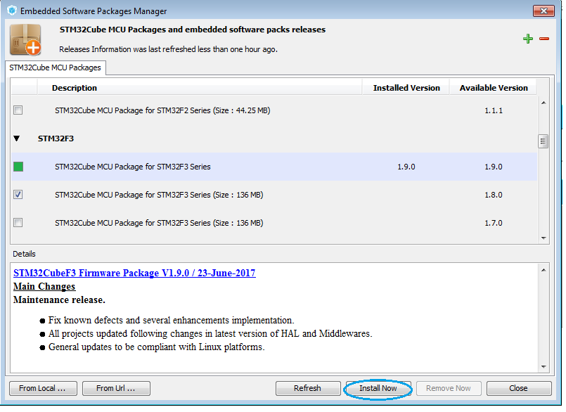

Posted on May 04, 2018 at 13:07
spica.lai
You're right, there is a problem in
installing
stm32Cubef3 package from local. It will be resolved next CubeMX release : 4.0. In the mean time you can install the
stm32Cubef3 package
a
utomatically from
CubeMX by
Select Help -> Manage embedded software packages ->Select STM32F3 1.9.0 for example -> select Install Now (not from local).
regards,
