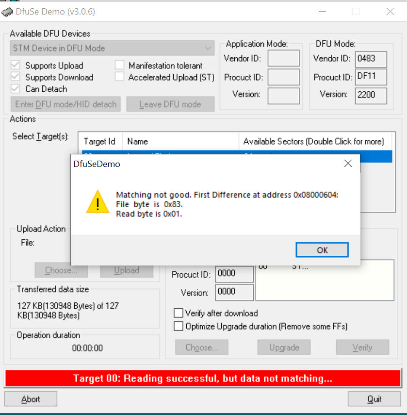

0693W000003RmlaQAC.pngThanks Berendi the above code . It is working fine. But I am trouble while upgrade the firmware using DfuSe application. I am using STM32F072 MCU and jump to bootloader address 0x1FFFC800. I am writing logic in such way that when i pressed the key then it will jump to bootloader.
Doing following steps for firmware upgrade.
1) press the key and it call Jump_To_Bootloader() function
void Jump_To_Bootloader(void)
volatile uint32_t * vect = (uint32_t *)0x1FFFC800;
__HAL_RCC_SYSCFG_CLK_ENABLE();
__HAL_SYSCFG_REMAPMEMORY_SYSTEMFLASH();
__DSB();
__ISB();
__asm__ volatile(
"mov sp, %[boot_sp]\n\t"
"bx %[boot_pc]\n\t"
:: [boot_sp]"r"(vect[0]), [boot_pc]"r"(vect[1])
2) Opened the DfuSe Demo (v3.0.6). The device is detected successfully.
3) Choose the dfu file and click on upgrade. The firmware upgrade successfully
4) When click to verify then it shows data is not matching. please find snippet. Due to this my device is not functioning properly.
5) When I do the Boot0 pin as high and do the firmware upgrade and do verify then the data verify successfully.
Thank you
Please suggest me.
