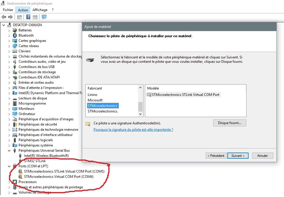

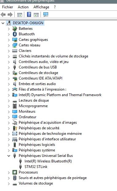

The driver
http://www.st.com/en/embedded-software/stsw-link009.html
creates only the a USB serial port as shown here :
So i try to add the Virtual Port Com Manually with the action ''add an old generation device'' in the Device Manager
I try to install the STMicroelectronics\STM32 ST-LINK Utility\ST-LINK_USB_V2_1_Driver\stlink_VCP.inf
or the STMicroelectronics\Software\Virtual COM Port Driver
or the STMicroelectronics\Software\Virtual comport driver\Win8
Even after removing one by one, and reinstalling one at times, no one is working
I try all the possiblities listed in many chats or forums
I also attach the USBView devices listing
Is there a new update for the 1.4.1 VCP Driver for windows 10 ?

Hi, thank you to add me to this conversation, and thank you for your answer but i really nead a virtual com port to use :
1_ The Arduino IDE (screen shoot is attached) 2_ The Clean Flight OSD (screen shoot is attached) for filght contollers
And i cant modify your driver because it must be signed.
For now the stlink v2 is completely unuseful for me, i just can upload firmware to my micro-controller or debug it thats all.
Thanks in advance.

Ok i think i got my real problem, i was trying to get the Virtual Com Port Working throw the St-Link v2, but when i plug another Usb cable usb to the USB of the stm32c8t6 borad the Virtual Com Port apears !
