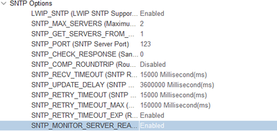

1: IOC file setup (within LWIP setup)

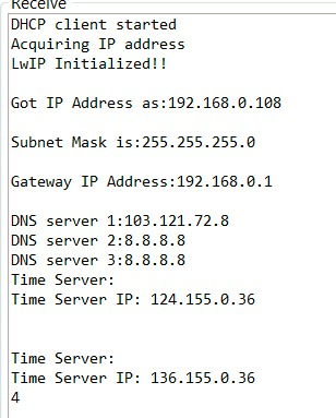

  Print_String("\nDNS server 1:");
  Print_String(ip4addr_ntoa( dns_getserver(0)));
  Print_String("\nDNS server 2:");
  Print_String(ip4addr_ntoa( dns_getserver(1)));
  Print_String("\nDNS server 3:");
  Print_String(ip4addr_ntoa( dns_getserver(2)));
  Print_String("\nTime Server: ");
  Print_String(sntp_getservername(0));
  Print_String("\nTime Server IP: ");
  Print_IP(sntp_getserver(0));
  Print_Char('\n');
  Print_String(sntp_getservername(1));
  Print_IP(sntp_getserver(1));
  Print_Char("\n");

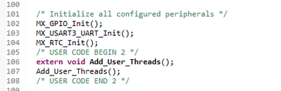

void Add_User_Threads()
  /* creat a new task to check if got IP */
  sys_thread_new("dhcpPollTask", dhcpPollTask, NULL, 256, osPriorityNormal);
to run this code created a new file and added to main.c as

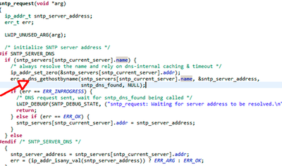

I may be getting error in sntp.c file of lwip in line
Any help please.
Thank you in advance!
Pavel A.
Which error do you see there? ERR_INPROGRESS or other?
User431
the dns query is unable to find correct ip.
also the direct ip method without dns is also not working. as sntp server is set to random value.
