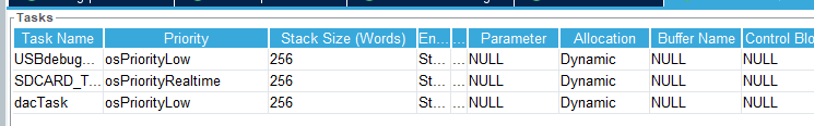

I fixed it, my Task priority needed to be raised to osPriorityRealTime

‎2022-08-11 9:08 AM
