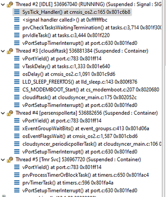

Eventually I bumped into the RTOS proxy feature. This did not work with the openOCD configuration - it just exists immediately without saying much more. When I chose the stlink gdb server, I initally wrongly chose the wrong PORT (ARM_CM33 instead of ARM_CM3_NTZ), which then makes the proxy report "cannot read registers".
When finally choosing the NTZ settings, It goes do the full stack unwinding!

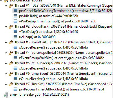

I am trying to use the RTOS debug proxy to view the task stacks in the debugger. CUBE IDE version 1.18.0 with NUCLEO-F303K8 and FreeRTOS as supplied with the STM32 toolset. I am using the ST-LINK GDB server. In the console I see:
STMicroelectronics RTOS Proxy. Version 0.17.0
Copyright (c) 2025, STMicroelectronics. All rights reserved.
'arm-none-eabi-readelf' is not recognized as an internal or external command,
operable program or batch file.
Failed generate debug info
Loading RTOS driver... FreeRTOS
Connecting to GDB server 127.0.0.1 on port 61234 ... Connected
Listen for GDB connection on port: 60000 ... Connected
Unknown data structure layoutxLIST
Update threads. Failed collecting threads.
and only Thread #1 shows up in the debug view. configUSE_PORT_OPTIMISED_TASK_SELECTION is set to 0.
