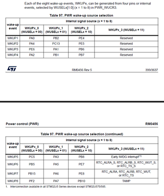

One quick update:
I found the the wakeup source selection in the manual and learned of its existance:
I also noticed that i configured the sleep duration not to 1 minute but to 30 minutes last week since i testet the sleep current. So user error on my side.
But I have on question: is the wakeup source selection required and if yes can the wakeup pins of wkup7 be used and the rtc wakeup at the same time or are they exclusive?

Just in case this is interesting for anyone: The magic missing line is the HAL_PWR_EnableWakeUpPin(PWR_WAKEUP_PIN7_HIGH_3) call which is in a user-code section and never generated by CubeMX, no matter how it is configured: https://github.com/STMicroelectronics/STM32CubeU5/blob/main/Projects/NUCLEO-U575ZI-Q/Examples/PWR/PWR_LPMODE_RTC/Src/stm32u5xx_hal_msp.c#L114
