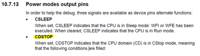

I have monitored the CDSTOP signal to verify if the system enters Stop 3 mode. It operates as expected: when the core enters Stop 3 mode, the "CDSTOP is set", and when the core wakes up, the "CDSTOP is cleared".

So CDSTOP gets cleared but the current stays at 3uA? That behaviour is pretty weird.
