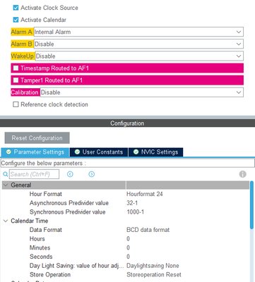

I am trying to use the RTC on a F401CCU6, but the values of the RTC don't change, and stay to what values I've set them in the IOC. I'm using the following function to get the time, and I read the values in the debugger.
RTC_TimeTypeDef sTime;
HAL_RTC_GetTime(&hrtc, &sTime, RTC_FORMAT_BCD);
The subseconds increments, but seconds and minutes don't. When I add an alarm, the alarm works correctly, triggering every second. The alarm follow the code present here https://wiki.st.com/stm32mcu/wiki/Getting_started_with_RTC.
Removing the alarm does not change anything.
I've also tried with a Nucleo f303k8, but even the alarm did not work.
Thank you for your time, I've added my configuration below.

‎2024-01-01 5:52 AM
‎2024-01-01 5:52 AM
‎2024-01-01 6:20 AM
Quite confused about why it works like that, but it works, thank you very much.
