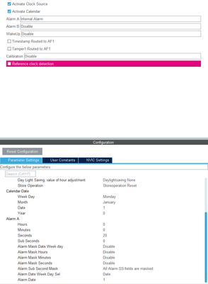

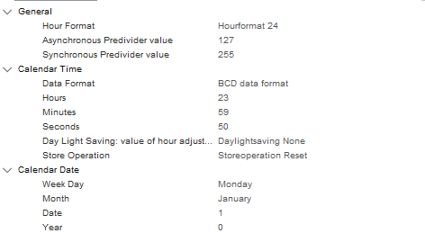

And here how i configured it in HAL

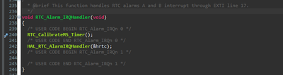

 And here I set a breakpoint in the interrupt file:

The problem is that it doesnt trigger an interrupt, i reset my RTC so the RTC and Alarm should match each other perfectly after i boot it on but it never triggers an interrupt.

It's about Alarm Mask.
Alarm Mask is used for ignore that field to compare with your alarm time.
As your config, You have no mask in any field so RTC are going to alarm on every 0:0:20.000 on Monday.
and If you want to alarm at second 20th every minute, you should try to mask in another field except second field.
RTC is going to compare your alarm time in second field 20th to RTC time in second field and alarm if it matched.
October 31, 2023
I know but i also reset my RTC so the date and alarm should match without the masks. (i also tried it before with the masks enabled but didnt work either)

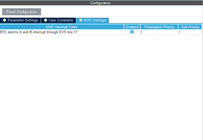

I too am having trouble with getting interrupts on seconds.   I have set two alarms, one for 00:00:00 on alarm A, and that works, toggling the LED, but the seconds alarm never fires.  I am guessing I have not set up the handlers correctly.  The NVIC is checked.  The above mentioned article appears to be a help, but I am not getting there.
Here is my stm32l4xx_it.d

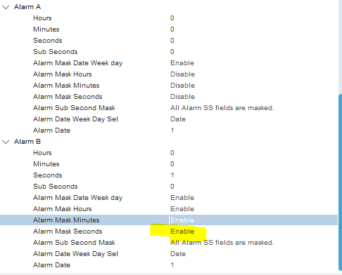

Attached are my alarm configureations.  I tried the seconds mask both ways, enabled and disabled with no difference.
