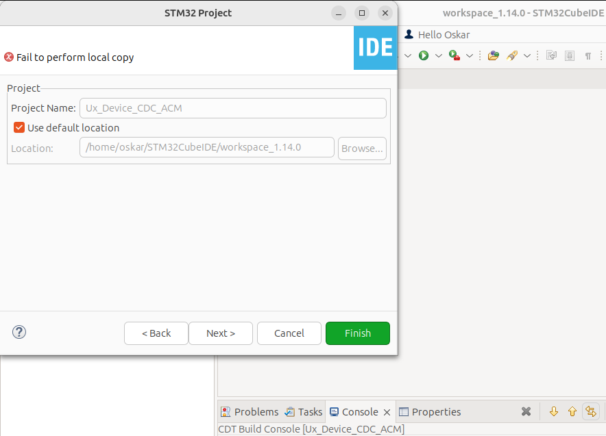

Yes, sure !
Here are the steps to reproduce the issue in STM32CubeIDE 1.14.0:
Open menu File > New > STM32 Project
In Target Selection window, click Example Selector tab
In Board Name, type STM32WB5MM-DK
In Examples list, select Ux_Device_CDC_ACM and click Next >
In STM32 Project popup, click Finish
Then after a while there is an error as shown in the screenshot below.
At the same time this error is output in execution log:
2024-01-26 18:27:04,899 [ERROR] com.st.microxplorer.mcufinder.util.ExampleToolKit.processExtraFiles(ExampleToolKit.java:1585) - File not found: ../../../Utilities/Fonts/fonts.h
2024-01-26 18:27:04,903 [INFO] com.st.microxplorer.mcufinder.util.ExampleToolKit.copy_engine(ExampleToolKit.java:887) - [WARNING] Project 'Ux_Device_CDC_ACM' installed with Warning(s)/Error(s)
2024-01-26 18:27:04,903 [INFO] com.st.microxplorer.mcufinder.util.ExampleToolKit.copy_engine(ExampleToolKit.java:908) - [info] 2024/01/26 18:27:04
2024-01-26 18:27:04,925 [INFO] com.st.microxplorer.mcufinder.util.ExampleToolKit.elapsedTime(ExampleToolKit.java:1027) - [info] Elapsed time: 0h 1m 41s 874ms
Then I click Finish but it just does nothing and there is still the error.
The only way to continue is to click Cancel, it closes the popup and the example is gone ! Then I cannot even build it...
Hello @Oskar_H
Thank you for your quick response.
I confirm I have faced the same issue (local copy) as you detailed. This issue is under investigation by our colleagues.
However, according to Utilities, they are not included in the x cube package and should be included by the user.
  • Middlewares/ST/STM32_Audio
  • Utilities/Fonts
Best regards,
FBL
