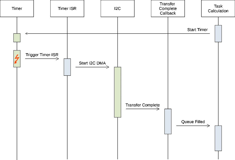

for acquiring Data I run a timer that does a I2CRead with DMA transfer and using a ISR for averaging
HAL_TIM_PeriodElapsedCallback -> HAL_I2C_Mem_Read_DMA
HAL_I2C_MemRxCpltCallback -> "Ava-Function"/Lowpassfilter
"AvgCnt ==16" -> "Schedule a Task"

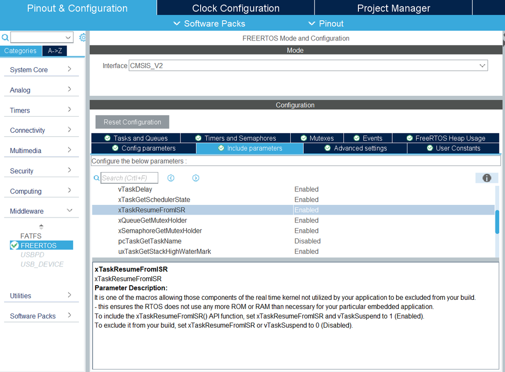

After 16 Averages I'd like to schedule a task(resume a suspended task) to do further calculation. For that purpose I think a task would solve the issue by using xTaskResumeFromISR buth that is not used in the osThreadResume, it presents an error of called from an ISR.

To give you more inside information, the processing takes longer than one ISR-Interval triggered by the timer. The Averaging is very simple, so it can be done in the ISR. The processing takes longer, it cannot be done within the ISR. That is why I need to do it in a high priority task.
I use a queue, but as far as I'm aware there is no "Task-Scheduling" attached, no resuming of tasks when a queue has new elements. This means a Task may be delayed/"suspended by a timer" and would have to asynchronously poll for values in the queue. However, I'd like to synchronize the value-processing so I get a better Realtime behavior.
To have some loose synchronization, within the Task itself is suspending the task. If the ISR is executed, it put values into the queue and then resume the task. The task will run and process the data and suspends itself once it is finished all elements in the queue. Even if the Task-execution takes longer, resuming it a 2nd time will not be a problem and the values of the following ISR's that may occur simultaneously will just be put into the queue.

P.S. What is very interesting is that the STM32CubeIDE has a checkbox for "xTaskResumeFromISR", however ARM's CMSIS V2 does not use it.

sorry for the late reply, I have found a solution that works, I have it running with two I2C's:
I do a avery simple PT1 average in the "TransferComplete" and every 32 averages I fill the Queue. If I have more time I will write a small documentation/tutorial.
