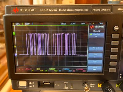

I am working with the FDCAN peripheral on the STM32N6 Nucleo Board. While logging all received and transmitted messages, I noticed that some messages are received twice.
Is there a specific reason for this behavior? Should I introduce a delay before reading the RxFIFO again?

Are you sure the message are not physically duplicated on the bus? did you check that with a CAN analyzer or an oscilloscope?
Hi @mƎALLEm ! Thank you for your quick response.
I checked and the message is sent twice indeed.
The slave is a STM32H563VIT6. In the code the message is only sent once.
I also checked the article :
https://community.st.com/t5/stm32-mcus/faq-fixing-stm32-fdcan-communication-disruptions-apb-bus-kernel/ta-p/730298
But the quanta clock is below the APB clock in both master and slave.
Any ideas of what can be happening?
Thank you!
guillerminaborrazas
Hello @mƎALLEm, I changed the APB clocks frequency to match the SYS clk, and the issue dissapeared.
