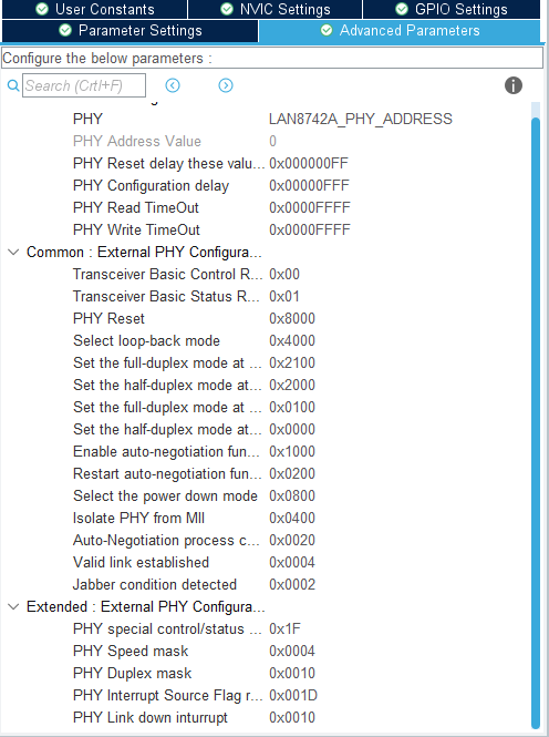

With the help of some analizing tools I found that ETH_TX_EN signal disappears randomly.
0693W000008zNQ6QAM.pngEthernrt controller settings are:
/* Init ETH */
 uint8_t MACAddr[6] ;
 heth.Instance = ETH;
 heth.Init.AutoNegotiation = ETH_AUTONEGOTIATION_ENABLE;
 heth.Init.Speed = ETH_SPEED_100M;
 heth.Init.DuplexMode = ETH_MODE_FULLDUPLEX;
 heth.Init.PhyAddress = LAN8742A_PHY_ADDRESS;
 MACAddr[0] = 0x00;
 MACAddr[1] = 0x80;
 MACAddr[2] = 0xE1;
 MACAddr[3] = 0x01;
 MACAddr[4] = 0x23;
 MACAddr[5] = 0x45;
 heth.Init.MACAddr = &MACAddr[0];
 heth.Init.RxMode = ETH_RXPOLLING_MODE;
 heth.Init.ChecksumMode = ETH_CHECKSUM_BY_SOFTWARE;
 heth.Init.MediaInterface = ETH_MEDIA_INTERFACE_RMII;
0693W000008zNQaQAM.pngCan anyone got a similar problem?
