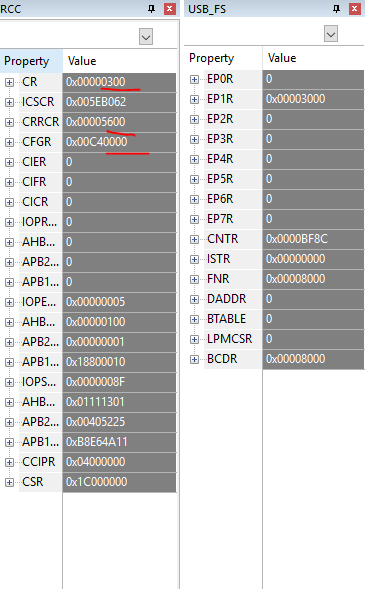

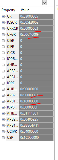

After ​SystemClock_Config,The RCC register as follow
​If run with breakpoint,the RCC register will modify the configuration correctly. Once run without breakpoint,
RCC register will be cleaned as follow:
Urgently need your help, if you need additional information or need to reproduce this problem, please feel free to contact me.

‎2019-07-21 11:58 PM
I have no idea what could cause such change in RCC/system clock settings. It's very unusual for the system clock to be changed during run. Again, you may want to set data breakpoint on some of the RCC registers to see, which part of the code causes the changes.
