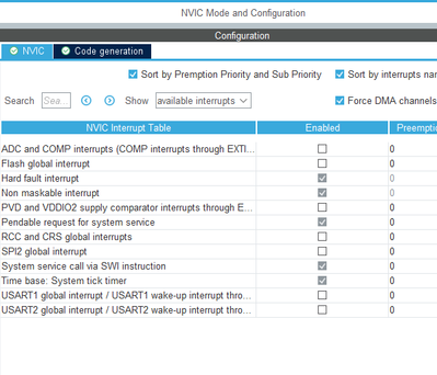

I am waiting for data from UART9 using HAL_UART_Receive_DMA(), and this data is processed within the threads. Now, I am starting to think that the interrupt system is not active after powering on.

LadyMt
To make it work, I replaced
HAL_UART_Receive_DMA(&huart9, rx_data, 1);
with
HAL_UART_Receive_IT(&huart9, rx_data, 1);
and now it works very well.
I don't understand why using DMA on power-up causes the UART not to activate. Do you have any idea?

If you dont stop it - it IS active .
--- as you set it in Cube -> nvic settings (priority, active or not ---check this. )
Just make the priority ranking with some sense - and the Azure sys timer is handeled by itself, you cannot change its settings. (TIM6 or whatever you give it...)
