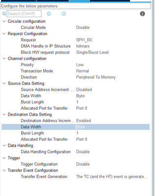

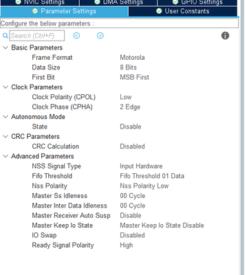

However, this only works for the first two packets. After those the DMA seems to get corrupted and is filled with random data. This doesn't seem to have anything to with the buffer overflow as the second packet only fills up the DMA up to the index 120. The DMA is 256 bytes long.
This is my DMA Setup:
And this my SPI setup:
First of all, can you guys tell me whether my concept is valid? And if yes, do you guys have any idea why it doesn't work after two packets? I also attached the project files reduced to the bare minimum. The EXTI can be found in the _it.c file and the processing function in app_freertos.c.
