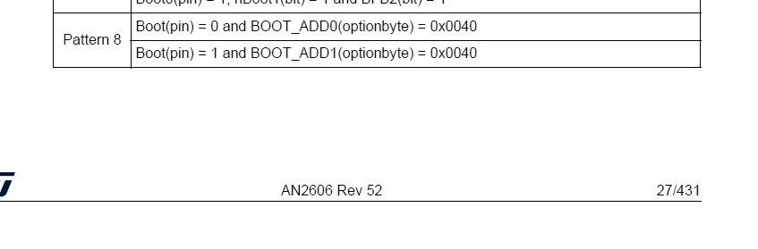

We are using the STM32H753 and cannot enter the bootloader using pattern 8.
AN2606 states that when BOOT0 is low and the option byte BOOT_ADD0 is 0x0040, then the bootloader is activated.
Does this work for the STM32H753?
Pattern 8

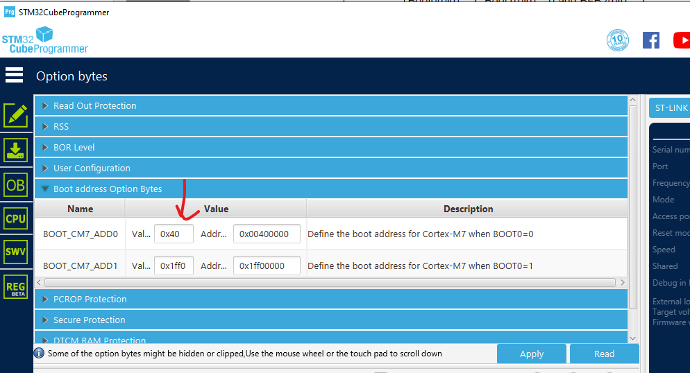

0693W00000KbAw4QAF.pngOption byte set to 0x0040 in STM32CubeProgrammer

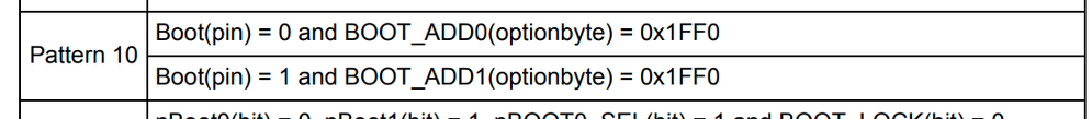

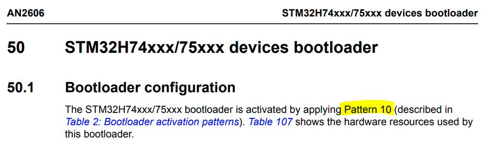

For the H74xxx/75xxx bootloader, AN2606 says the bootloader is activated by pattern 10, not pattern 8.
Pattern 10:

Ok I tried this again. With my setup, I seem to have trouble entering into the bootloader on a power cycle. If I reset the processor by pulling NRST low and releasing I can communicate with the bootloader.
