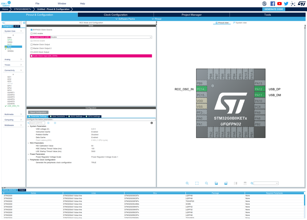

May 12, 2021
It is selectable in CubeMX, although that doesn't mean a ton.
