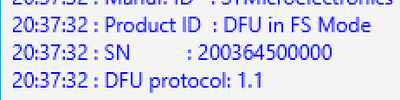

On STM32F4x and STM32H7x boards, the "SN" field as reported by STM32CubeProgrammer appears to be random. Don't have an F7x board to test.
@TDK , thanks for the reply.  I also did not see anything about the SN used in DFU in the documentation (thanks for confirming that).  As illustrated in your screen captures, you are seeing some sort of hash based on the 96-bit unique ID (I'm basing this on previous posts and some Googling that have shown how reverse engineer this hash).  If you have two of the same MCU, I suspect that you will see different serial numbers.
