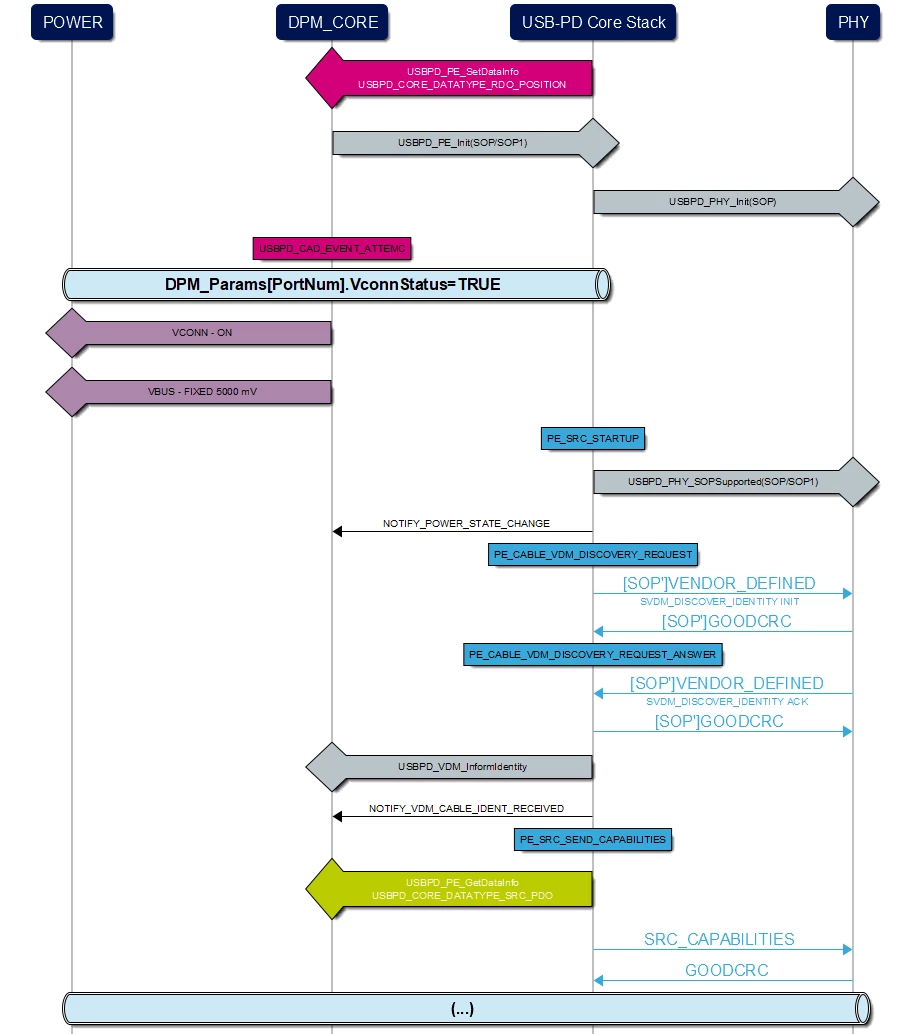

Hi Sir
I used the same e-marker cable that i tested with FUSB307BGEVB.
The Ra in the cable can be detected when i used the FUSB307EGEVB but it didn't be detected by the STUSB1602.
I tracked the code i found that when cable attached then the register value of 0Eh was 2Dh which means Sink attached.
But i except to see 2Fh which means Powered cable with sink attached.
In the STUSB1602 evb i close the JP400 that makes Vconn from the local regulator.
Dose the STUSB1602 needs to configure other setting to detect the Ra ?
I have read the UM2191 but can't find any hint.
Please give me some suggestion to fix the issue.
Thanks.

Best answer by Yohann M.
Dear @John886​
To get only 1 thread regarding your question, I'd prefer answering to the following question raised in another thread:
"I set the sop and sop_1 support in the usbpd_dpm_conf.h but when PE stack calls the USBPD_PHY_Init it just sets the SupportedSOP to sop."
"PE_SupportedSOP" defined is used to enable, if necessary, communication on SOP'.
Please find the stack behavior related to EMC cable detection:
1) Stack will communicate with cable only if a cable is detected. It means that by default, PHY will not acknowledge message from SOP' (what it is done by USBPD_PHY_Init function).
2) if cable is detected (USBPD_CAD_EVENT_ATTEMC event in USBPD_DPM_CADCallback function), the flag 'VconnStatus' is set to TRUE.
3) When stack is started, a check is done on this flag and automatic reconfiguration of PHY is done to be able to receive message from SOP' (through USBPD_PHY_SOPSupported function).
I hope it will clarify some points.
Rgds,
Yohann

I solved the issue.

Hi JW
After i tracked the code, i found we need to define the _APPLI_VCONN_SUPPORT to enable the Vconn supply on the stusb1602.
But after i can detect the e-Marker cable, there some issue on receiving the message from VDM request neither sop nor sop_1.
I think maybe there some issue on the PE stack that ST provide as library file that means i don't have the source code, so i need more time to figure out what causes the issues happened. ​
Thanks.
John.​

Hi Yohann
Thanks for your explanation.
I got how PE stack works when e-marked cable attached..
