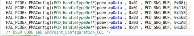

I configure endpoint in my project using
HAL_PCDEx_PMAConfig((PCD_HandleTypeDef*)pdev->pData , 0x84 , PCD_SNG_BUF, 0x150);
and data writes to it by USB_EPStartXfer that calls USB_WritePMA and PCD_SET_EP_TX_CNT.

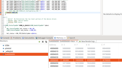

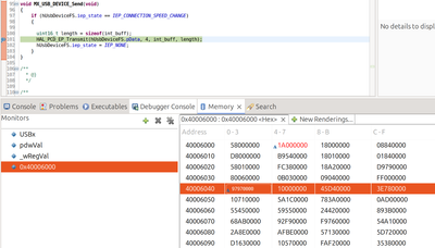

@FBL Thank you for your reply
When I just init device it is ok.
As you can see in the picture memory contains correct values
But before sending response memory is curupted
During debugging I didn't found where it could happen.
I didn't find why BDT for endpoint 3 and 4 is changed by some code. I tried to set watch points and debug fw but, debugger stops incorrectly. For my task I start to use endpoint 5, for which BDT stays correct after configuring it and it works as described in programming manual.
