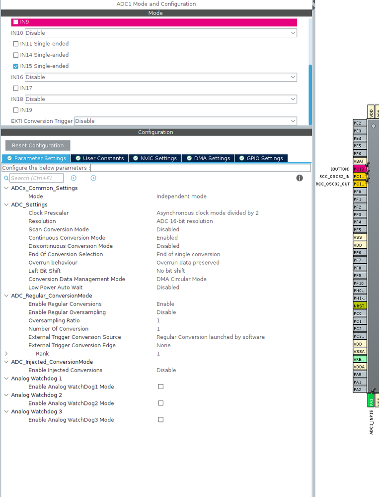

  I am trying to have the ADC Continuously trigger and fill the DMA buffer overwriting the old values.
I'm not attempting to trigger from a timer or any external means. I just want to start the ADC and it be free running. Then I'll handle the data in the buffer else where.

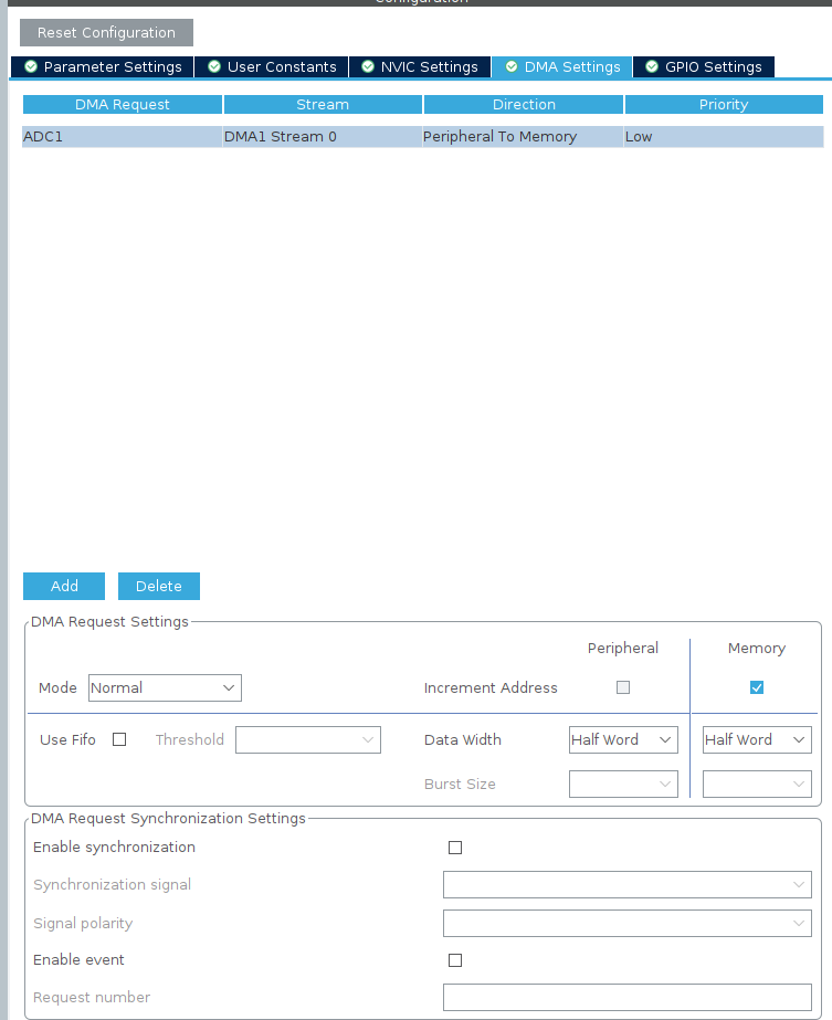

  I can't get anything to happen. The ADC works fine if I set it up for polling and I get correct ADC values. If I set it up for DMA continuous the buffer never gets any values and the ISR HAL_ADC_ConvCpltCallback() never fires. (I used a debug break point inside the isr)
Update: I found that if I check the ADC_HandleTypeDef hadc1 while debugging it has a ErrorCode == 4 and the DMA_HandleTypeDef hdma_adc1 has an ErrorCode == 1

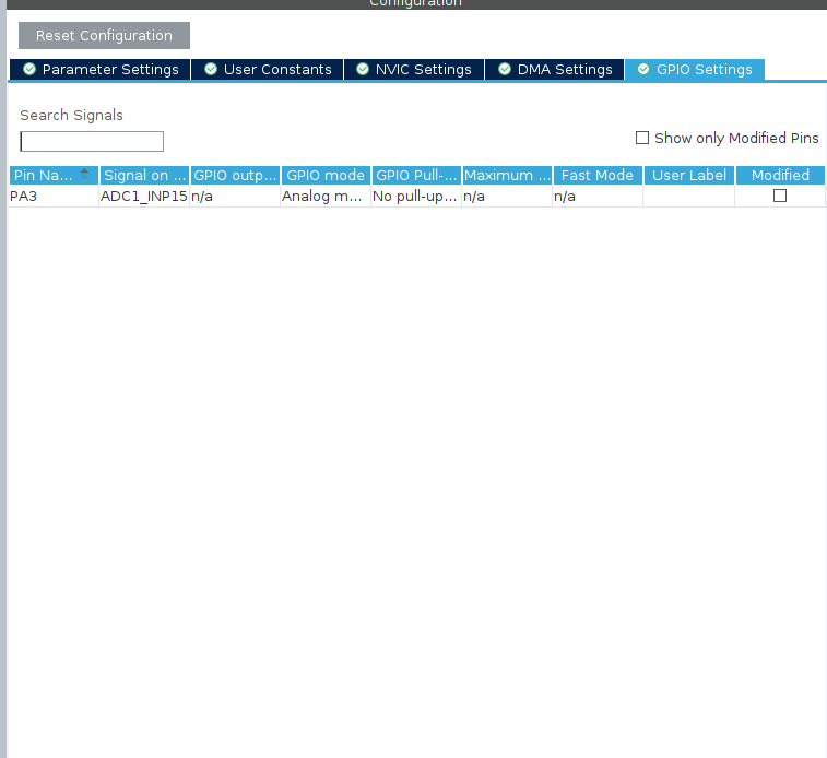

Once the project is created I set PA3 to ADC1_INP15 and use the following settings
I also included my main.c along with my .ioc

I don't see the specific purpose for DMA in this scenario.
With continuous conversion, you can equally well fetch the results from the ADC register directly.

1) Ensure the buffer is placed somewhere the DMA can access. Sounds like this is the primary issue.
DMA is not working on STM32H7 devices - STMicroelectronics Community
2) Set DMA to CIRCULAR mode, not normal, if you want it to continue more than one buffer-loop.
Consider loading a working ADC/DMA example and going from there.
